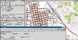

Heads up digitizing with v.digit
screenshot: O. Dassau

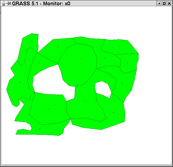

Vector overlay using v.overlay
Input A and B
screenshot: R. Blazek

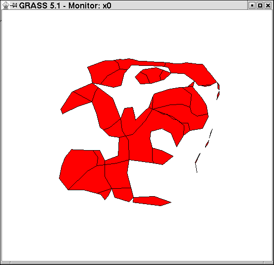

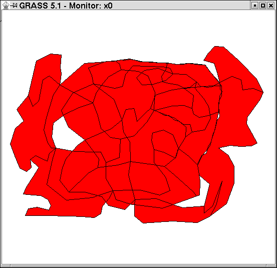

union (operator=or)

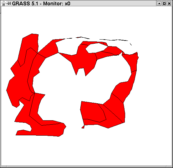

not (operator=not)

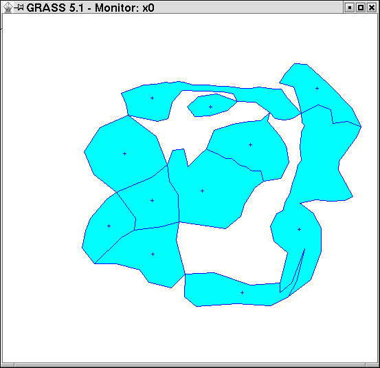

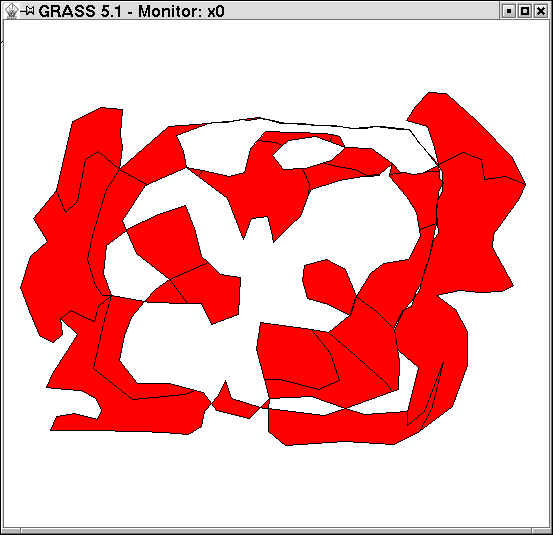

exclusive or (operator=xor)

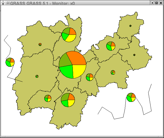

Charting using d.vect.chart
Pie charts (default)

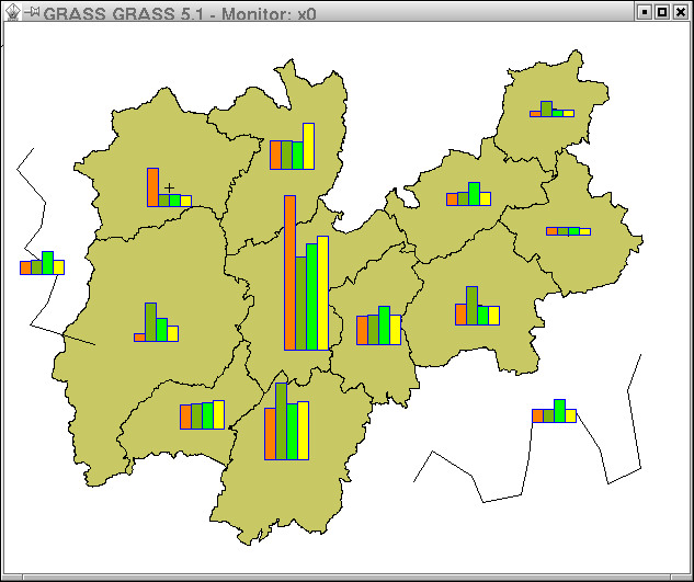

Bar charts (ctype=bar)

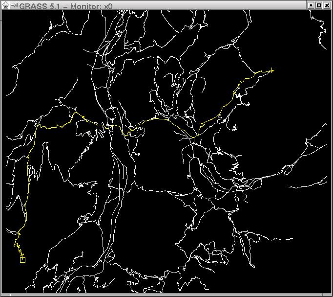

Shortest path using d.path

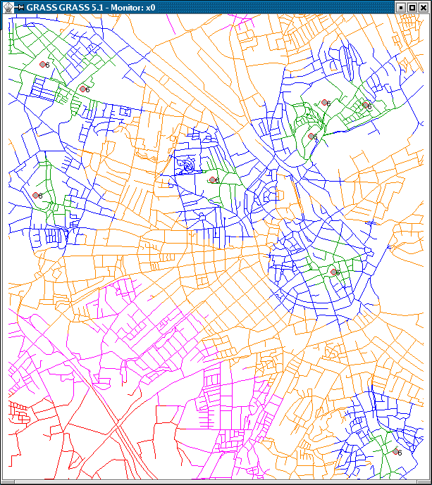

Split network into bands using v.net.iso

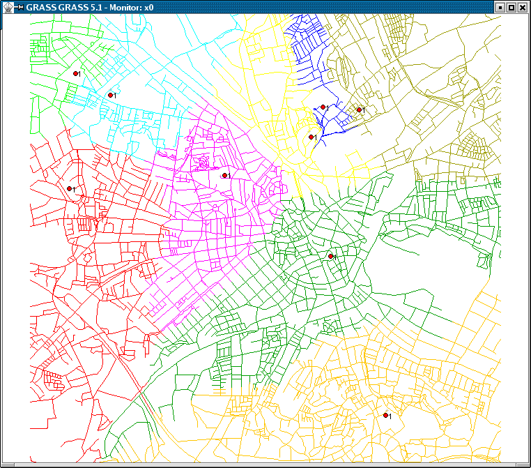

Allocate subnets using v.net.alloc
